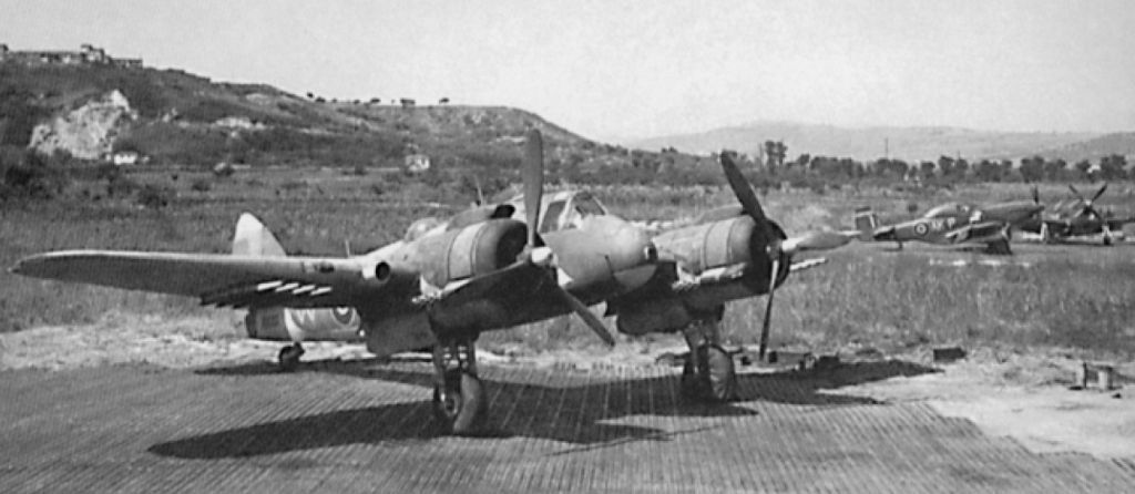

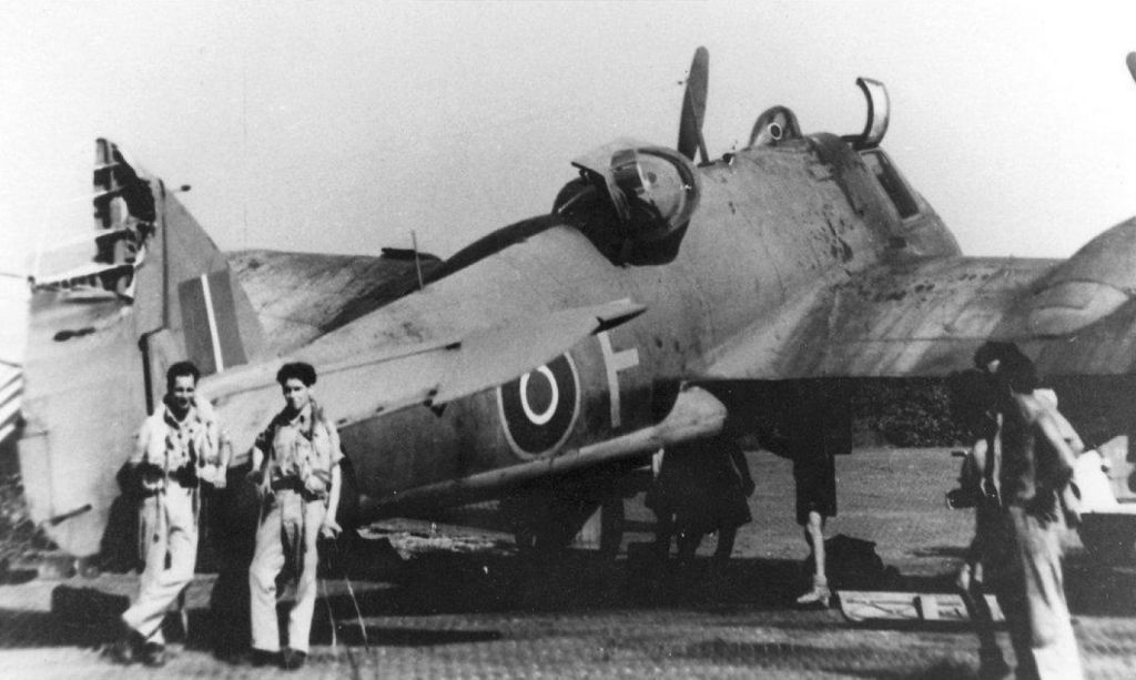

Beaufighter 'F' iz 39 Sqn.

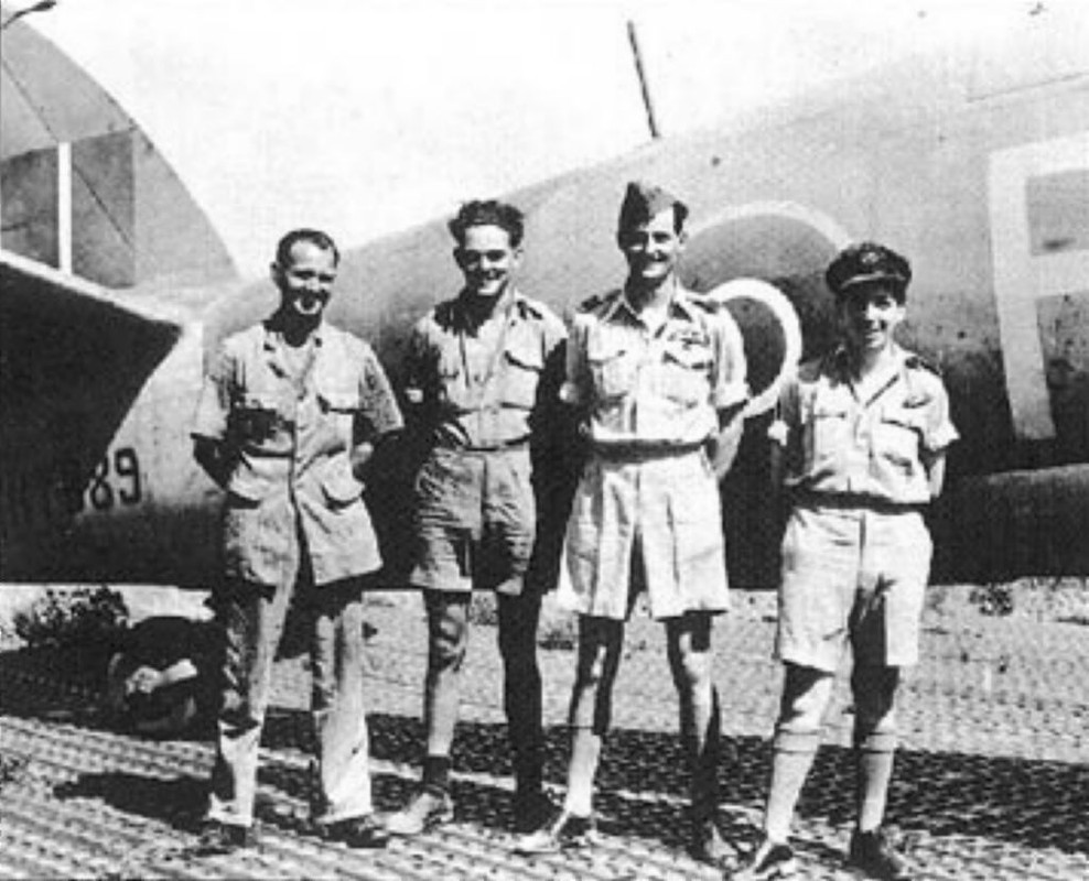

Pogled izbliza na serijski broj
Već sam davno prije rekao u jednom postu o Borongaju:
"10.10.1944. Šest Beaufightera iz 39 Sqn BAF napalo Križ, u blizini Zagreba, i oborilo Do 17 koji se spuštao na Borongaj. Obaranje je prijavio P/O I.D. Wallace, koji je letio na Beaufighteru X NT889/F."
Žrtva je bio Do 17Z W.Nr. 3240 9H+EL, Nahaufklärungsstaffel Kroatien. Hauptmann Georg Stark, Major Paul Lube (Fliegerführer Nord Balkans) i Gefreiter Helmut Fischer su ranjeni, a Unteroffizier Ernst Weise je poginuo.
Iz orb: "Almost clear skies and unlimited visibility enabled six Beaufighters to carry out an attack against barracks and sidings at Kriz, Yugoslavia, this morning. The aircraft led by Sqn Ldr Payne attacked the target and caused damage to three barrack buildings and 30 box cars in the sidings. As the aircraft were leaving the target they saw a Do 217 returning to Zagreb
aerodrome. Plt Off Wallace DFM attacked immediately, causing damage to the Do’s starboard engine and the enemy aircraft made a crash landing. It was again attacked on the ground and burst into flames as the petrol tanks blew up. Return fire was at first encountered from the Do’s rear gun,
but Plt Off Wallace silenced this during his attacks."
No bio je to i posljednji let Beaufightera NT889/F s kog se vratio čitav.
NT889 bio je samo jedan u nizu Beaufightera 39 Sqn RAF koji su nosili kod 'F', a u lipnju 1943. su zamijenili torpedonosce Beaufort.
Bili su to:
JM413/F Zapadno Sredozemlje, ljeto 1943. Naoružan torpedom. Povremeno na njem lete posade iz 47 Sqn, koje se uhodavaju u torpednim napadima.
LX883/F Zapadno Sredozemlje, jesen 1943. Kasnije u 47 Sqn, koji je preoružan torpednim TFX i poslan na istočno Sredozemlje. Pao je kod Lerosa u studenom 1943.
NE412/F Alghero, Sardinija, proljeće 1944. Naoružan raketama.
NE383/F Biferno, Italija, do sredine ljeta 1944.
NT889/F Leti na Paraćin 15.8.44., Solun 25.8., Sunju 2.9.44., Knin 19.9.44. Napada Križ 10.10., tad Wallace obara Do 17 nad Borongajem. Idući dan pogođen je flakom u napadu na torpedne čamce i slupao se kod Ancone.

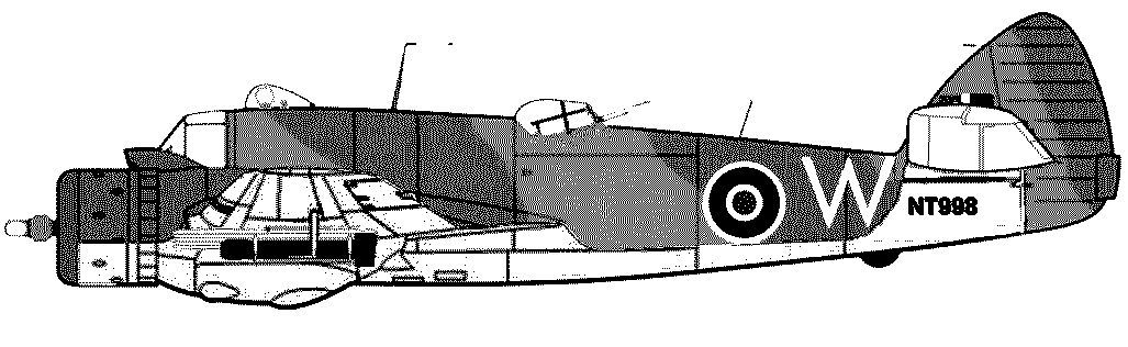

NT998/F Leti na Novsku 25.10.44. Dok ostali Beaufighteri 39 Sqn lete na Bjelovar 2.12.44., NT998 prevozi 2 oficira u Nikšić. Nakon što je početkom 1945. godine 39 Sqn preoružan bombarderima Marauder, NT998 nadalje leti u 16 Sqn SAAF kao 'W'.
NT998/W 16 Sqn SAAF. Srušen je za napada 4 Beaufightera na Dobovu 8.2.45. Pogođen flakom krenuo je na sjever. Nakon što je ugasio motor nastavio je planirati još nekoliko kilometara i vrlo se grubo spustio. Posada (Bodley/McClelland) viđena je kako napušta olupinu, mahnula zadnjem Beaufighteru i krenula prema zapadu.

Rekonskrukcija NT998 u 16 Sqn SAAF. Boje su Dark Slate Grey i Extra Dark Sea Grey gore i Sky dolje.

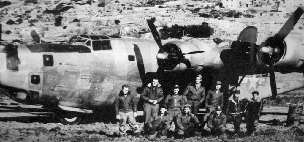

sem novi član na tem forumu in imam vprašanje. Ali kdo pozna ("ime" ali s/n številko) za ta dva bombnika iz Visa ?
Hvala za pomoč.

Nažalost Ivane usprkos puno truda i traženja nisam do sada uspio identificirati ova dva B-24; možda u međuvremenu izroni još koja fotka gdje se vidi malo više? Inače B-24 sa simbolom mazge ili konja na nosu snimljen je na stajanki sjeverno od poletno sletne staze a ovaj drugi, broj 36, na otpadu istočno od staze.

Ovaj drugi broj '36' je iz 451 BG 726BS, serijski broj' 41-28955, ime KLUNKER. Prisilno se spustio na Vis 13.10.44. Pao 17.11.44.

PorukaUpisano: Uto Velj 18, 2020 12:53 pm    Naslov poruke: Citiraj ovaj komentar
Zoran hvala za informacijo. Sedaj grem s pomočjo "strica Googla" v iskanje fotografij "Klunker"-ja. Upam, da bom našel še kakšno fotografijo tega bombnika !? Confused
avtomoto
Član od: 17 Velj 2020
Poruke: 9
PorukaUpisano: Uto Velj 18, 2020 5:39 pm    Naslov poruke: Citiraj ovaj komentar
Zoran, glede iskanja bombnika "#36" v mojem postu sem dobil drugačne podatke. Očitno na fotografiji NI #41-28955 "KLUNKER". Prilagam dva mnenja:
"Sorry Ivan. Good thought, and it was indeed #36, but 41-28955 was a Douglas (Tulsa) built aircraft, and the #36 in the image
is Ford-built and that damage was beyond the Vis crew to repair.
Bob"
in
"Regrettably, this specific #36 isn’t the same as #36 41-28955, an earlier a/c assembled at the Douglas Tulsa plant in Oklahoma.
The #36 seen in your photo is a later model, which certainly was manufactured at the Ford Willow Run plant in Michigan.
It is either a late J-FO, or an early L-FO; the Group belonged to the 49th Bomb Wing, probably the 451st BG....
Gino"

Isprike svima, moja greška. Već dugo imam tu fotku s (olito krivim) potpisom "36 Klunker", a nisam provjerio detalje (jer je bio na Visu, a i oblik oznaka odgovara 451 BG).
Još jednom isprika.
Zoran
Poruke: 1515
PorukaUpisano: Sri Velj 19, 2020 8:30 am    Naslov poruke: Citiraj ovaj komentar
Dakle oba B-24 sa Visa ostaju do daljnjega bez identifikacije...
